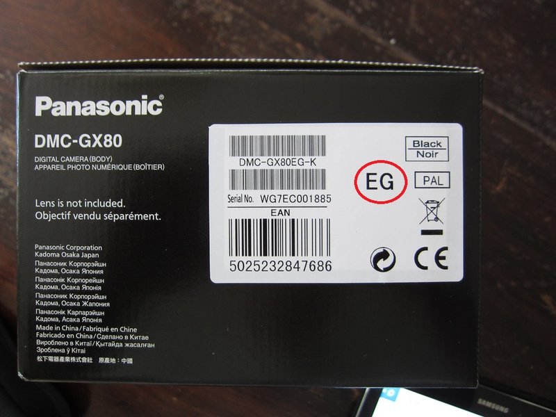

Here you have to pay attention. Get the box of your GX80. On the outside with the barcode etc., there is also the regional code written on the box. It is something like the 4 options you see on the screens.
  • Canon - Canon IXUS 300 HS
  • 4.9-18.6 mm
  • 4.9 mm
  • ƒ/2
  • 1/30 sec
  • ISO 125
The photo above shows my box with the regional code "EG"
Pick only the regional code which is also written on your individual box. This is not always "EG". This is important I guess (there must be a reason why Panasonic labels 4 different regional codes for the GX80 at least)
In the image below, the regional code "EB" is selected just as another example.
So you highlight the regional code which is written on your individual box and you can see in the upper right hand corner the word "strict". Press once the "Display" button in the lower right hand corner and this word disappears.
You have to disable this "strict-mode" before you continue, otherwise the next steps will not work. So make sure that this word "strict" disappears really before you continue ;)
