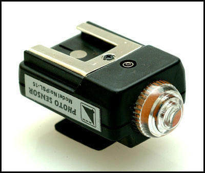

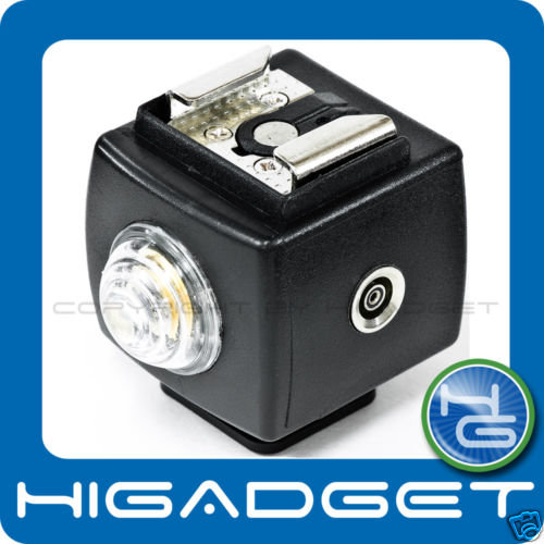

You can pick-up a Sigma DG EF 610 Super....it is 100USD more and well worth it...you can still put an optical trigger on the other flash and use it as a slave on full power...
If you are looking for a cheapy....Bower makes one for about 130USD....

I was thinking about reselling my 500 DG ST, butthe idea of using it as slave is not bad at all ;)
